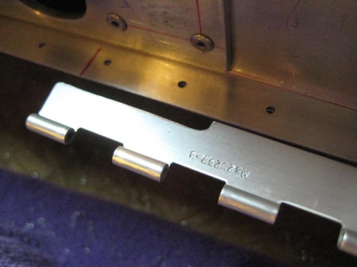

- Cut and located the flap and aileron hinges.

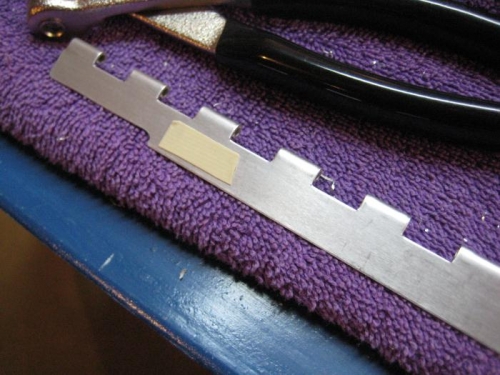

- As on the other wing, I used double-sided carpet tape to hold the hinges in place while checking for and adjusting the hinges to be perfectly straight.
- Then the hinges were clamped into place for pilot drilling
- All the pilot holes were completed in the flap hinge, and clecos were installed as I went along. Then all the holes were up-drilled to size.

Flap hinge notched around reinforcing plate.
Double-sided carpet tape.
