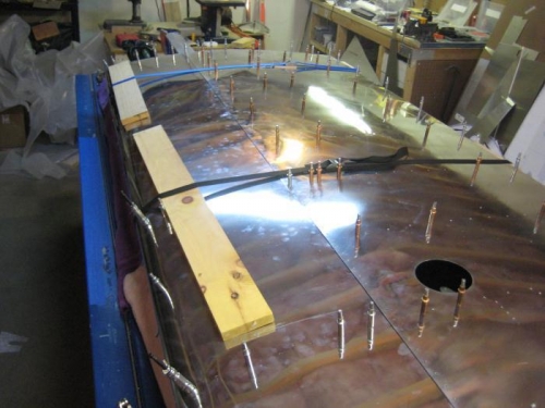

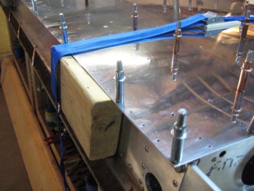

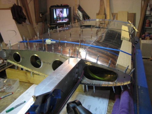

Install RIGHT leading edge skin
Used nylon straps to pull the nose tight to the ribs and back far enough across the spar cap.
Began drilling into the ribs and cleco'ing.
2x4 in rear spar to keep straps from crushing the flanges of the rear spar.
