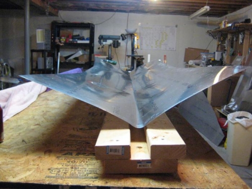

Finished bending the second leading edge skin with the vacuum bagging method. The next page shows the result.
The bend angle after the brake, but before the vacuum bagging.

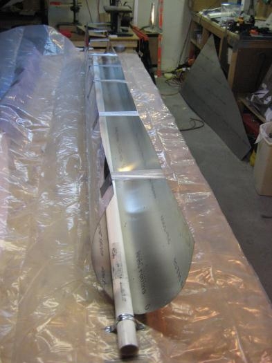

PVC pipe clamped over plastic, and the edges being drawn up.

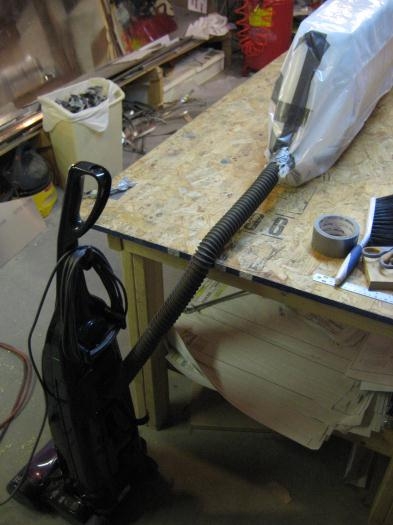

Home vacuum cleaner inside of taped bagging.
