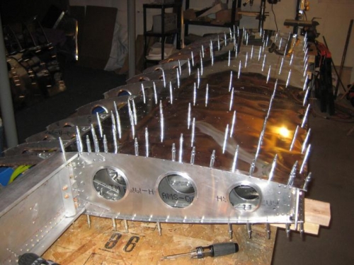

RIGHT wing - aft upper skin
- Flipped the wing over (with the help of my wife; she's quite good at it, now)
- Drilled and updrilled the 8 holes for the aileron bellcrank brackets
- Laid out the skin and pilot drilled all the holes into the ribs
- Only drilled the pilot holes for 1/10 of the main and rear spars, so that will be the next thing to do before updrilling at the ribs
995.5 hours into the project. Getting closet to 1K!
Another porcupine!

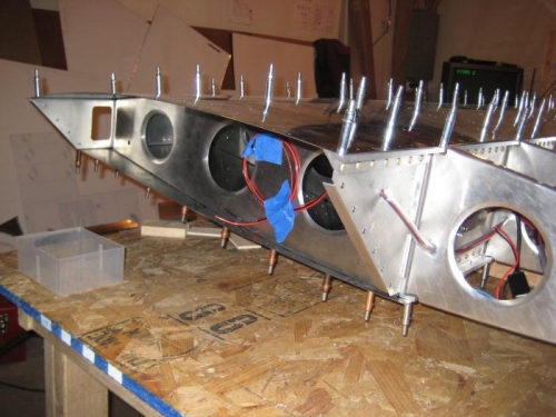

The right wingtip

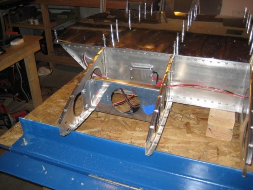

The landing light bracket
