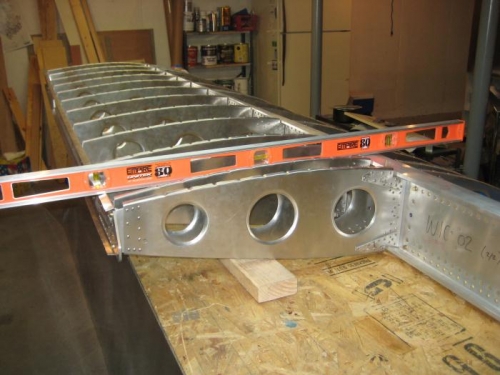

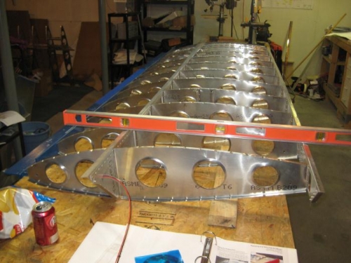

There are at least two ways to align the wings so there is no twist. One involves 2 saw horses and some vertical piano hinge wire. The Sonex manual shows the method I'm using here, and for various reasons I decided I liked this better for my project.
Pictures 1 and 2 are leveling the wing at the tip and the root, to make sure there is no twist.

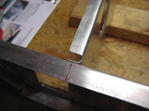

In picture 3 you can see the Sharpie lines I drew down the centers of all the ribs and the rear spar so I can align the pilot holes in the skin with the ribs below.

Level at the tip...
Level at the tip...
Level at the root.
Level at the root.
Rib alignment lines.
