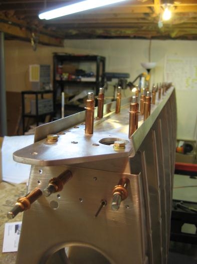

- The very first rib set I went to install today, I made DUMB mistake. With the wing across the sawhorses, and me sitting in a chair next to it, I can't see the forward ribs unless I look underneath the spar. I cleco'd and riveted the aft rib and THEN noticed I forgot the forward rib!!!!!!! Aaarrrgggghhhh!!!! Dummy!
- So drilled out the rivets and did it the right way.

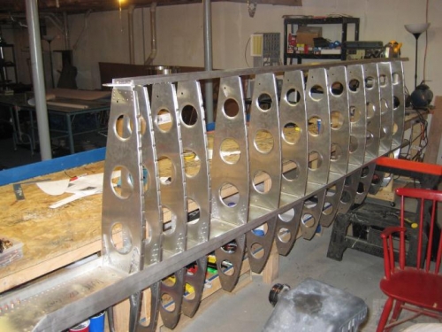

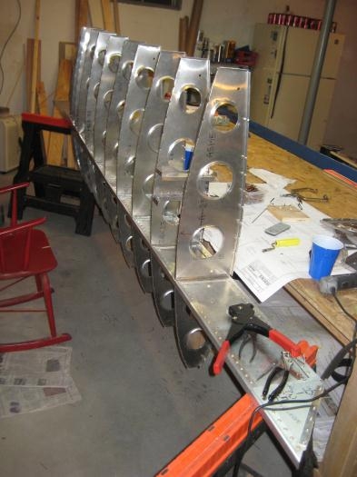

Installing the ribs.
About to rivet the rear spar to the aft root rib and the rest of the ribs.
Skeleton of left wing complete!
