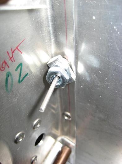

When riveting the ribs to the spar web of the inside ribs, I was having a devil of a time getting in under the spar caps. Someone on Sonextalk suggested adding some small nuts on the rivet mandrels to hold the nose of the rivet gun off, but still apply the pressure to the rivet head (picture #1). It worked quite well!

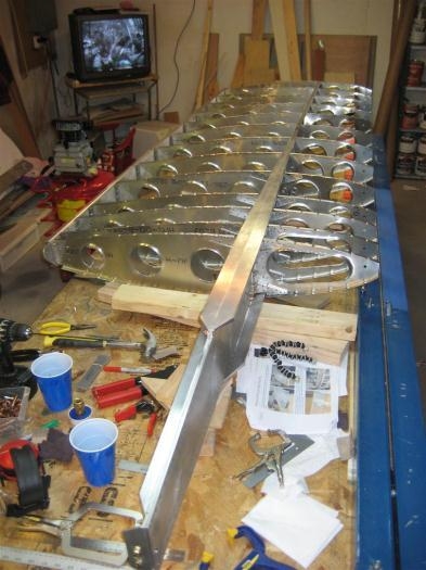

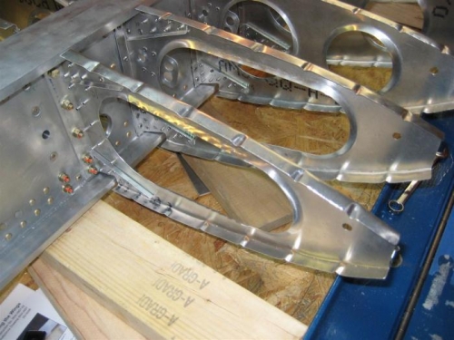

In picture #2 you can see my modified ribs to allow easier access to the flap rod hardware. Unfortunately it was not the #1 rib I was supposed to modify; only the root rib. I had been calling the #1 rib the root rib, even though it really wasn't. Due to my mix up in the term I mistakenly modifed the #1 rib. When I went to install the final ribs tonight and I cleco'd the #1 in place, it finally dawned on my my error. So I simply made the same modification to the root rib, and the #1 rib will simply have an unneeded modification. Maybe the plane will go faster with less weight!

Angled ramp against rivet, with 2 nuts.

Oops. Now I have 2 ribs with a larger opening.

Right wing rivets completed.
