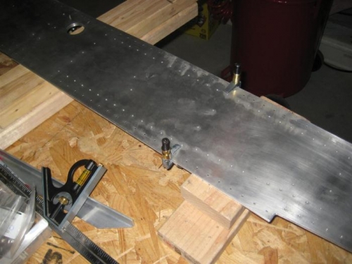

I started laying out the angles that attach to the root of the wing spar webs.
1. The web pieces are held in alignment with clecos.
2. I laid out the angles per the plans and clamp them in place with cleco clamps.
3. I flipped over the web and laid it across stacked 2x4's (due to the clecos hanging down.

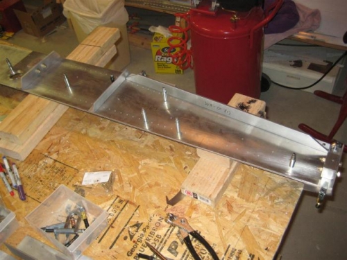

4. I dirlled out the holes and put in temporary bolts/nuts to hold them in place.
I have a couple more angles to do, then the rest will wait until the spar caps arrive. In the meantime I'll need to countersink some holes for flush fasteners, and dimple some other holes.
Web flipped over. Angle on other side is held in place with these cleco clamps.
All the angles located and drilled tonight
From another angle...
