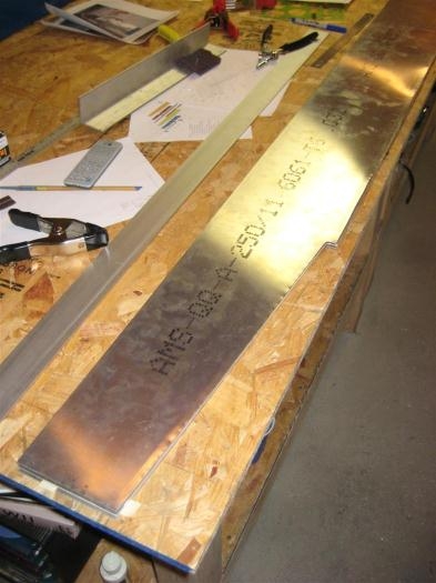

Finished deburring all the holes in the web pieces for the first wing spar.
Started the process all over again with spar #2. The order of how the webs are stacked is different for this spar, but laying them all up in the same order as the first spar keeps W10-01 completely exposed to use it as the pattern. After drilling and deburring everything will be laid up in the correct order.

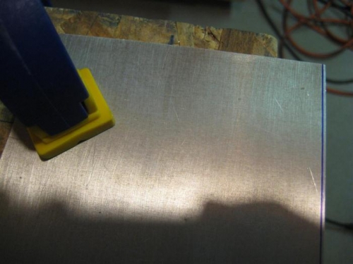

W10-03 needs a bit shaved off the top edge

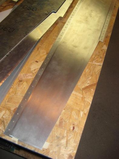

Like the previous spar web, W10-01 is laid down, then W10-03 is aligned on top & taped down
Then the other 2 web pieces are laid on top and aligned
