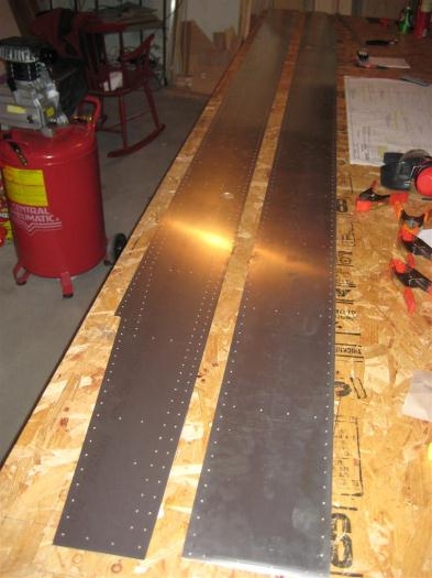

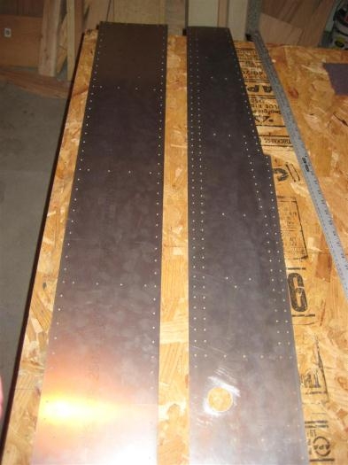

Deburred side 2, and therefore finished the first wing spar web (W10-01).
I used this first one as a template for the second one. I laid one over the other, aligned and clamped. Then used a sharpie inside all the holes to lay out the hole pattern on the second web. I got all the holes drilled in the second web. Tomorrow will be the deburring.
A LOT of damn holes!
