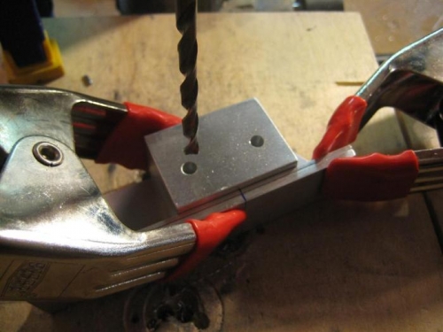

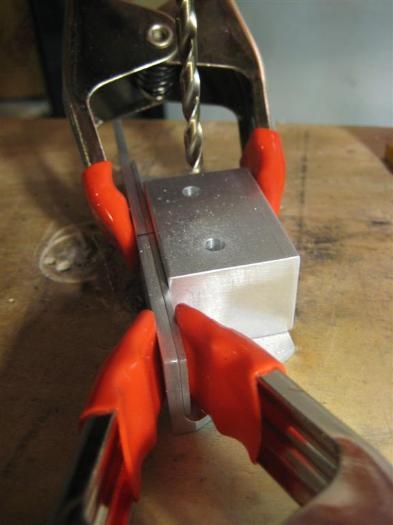

- Used the W11-05 angles and two of the attach blocks to make the W11-02 wing attach assemblies. I already had the holes drilled in the blocks, so I clamped the to the angles with the required spacer, and used those holes as guides to drill through the angles. I'm not worried about making the 3/16" holes in the blocks larger by doing it this way, since those holes will be enlarged for tight-fit bolts later.

Drilling thru the blocks to the angle
The setup of the clamps allowed the angle to lie flat and square

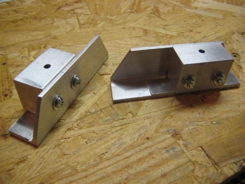

The finished W11-02 assemblies (with temporary bolts)
