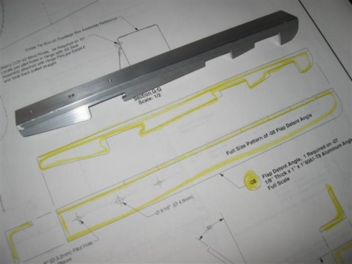

Fabricated F08-08. This was the most intricate piece I've made yet. Used a full size paper pattern glued on with a glue stick. The glue is water soluble, so the paper and glue came off with water after fabrication.

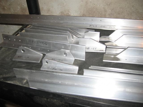

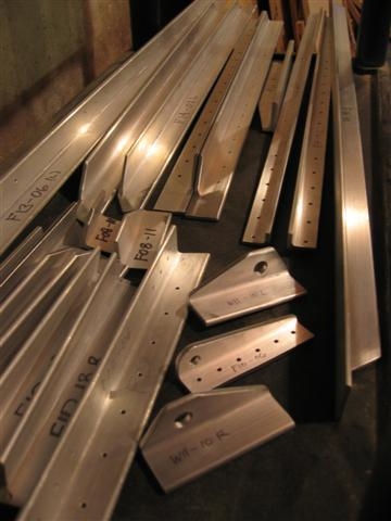

Finished F13-03L, W11-10L & -10R.
F08-08
Many of the parts completed to date
