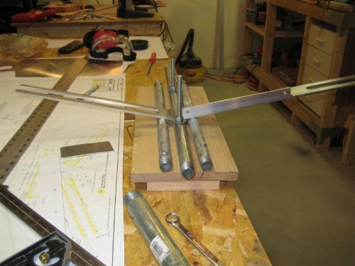

T06-03... Finally!
FINALLY finished T06-03 by bending both ends up to 22 deg.
Let's see, that only took about 7.5 hours to make, from start to finish.
More pictures on the next page.

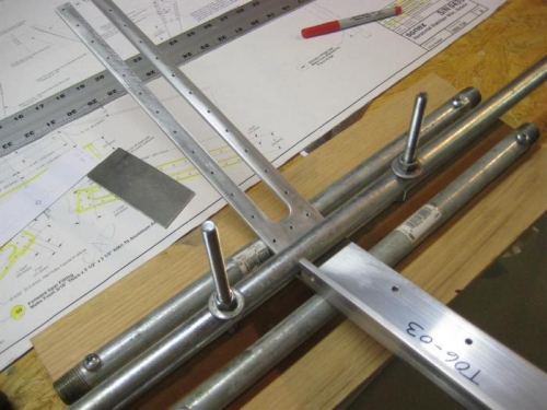

T06-03 in the bending jig.
1/2" galv pipe w/ 3/16" bolts. Tighten down and, ta da!

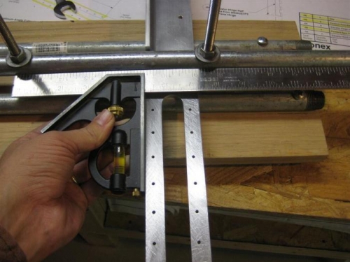

Checking to make sure it's square to the bending jig.
