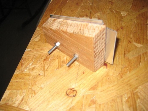

Bent half (16 of them) of the W15-08/-09 gusset stock. When these things are finally done, they will have been the most lengthy and time consuming parts yet. There's always more to do with these, and there are a lot of them.
In the pictures you can see the wood bending blocks I made; one with a bevel in each direction, since half the gussets bend one way, and half bend the other way.

A bending block with gussett stock in place, and held with bolts.

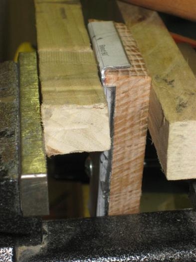

The whole assembly in the vice. The two blocks of wood on either side are the sacrificial pieces.
