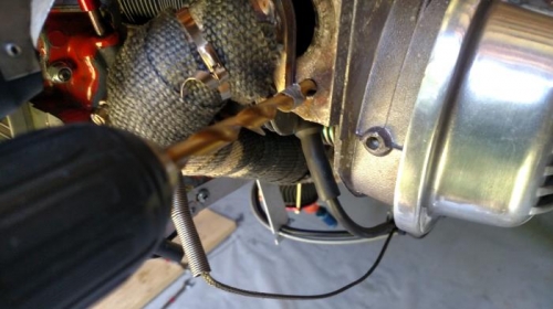

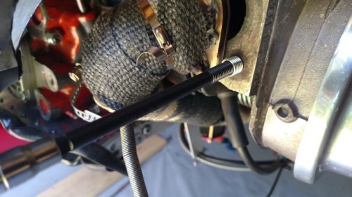

Brief Description:  Helicoil for stripped bolt hole 1 of 2
During my annual inspection I found the lower bolt hole in the left head (#2 cylinder) that holds the exhaust flange, was stipped. So I ordered a helicoil kit and fixed it today.
The exhaust flange had to be moved to the side to do the work, so all 4 exhaust bolts had to be removed to slide the exhaust over. After that it took 10 minutes to do the work.
Drill...
Drill...

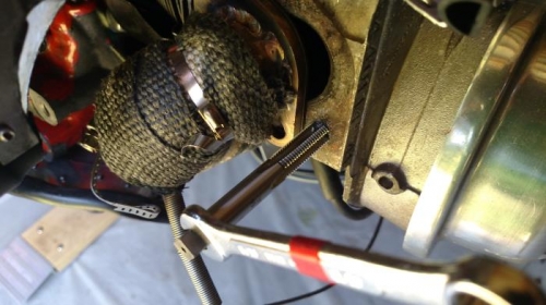

Tap...
Tap...
Install coil.
Install coil.
