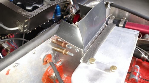

- Installed the new baffle materials at home. I used the straight-edge stuff this time, and left plenty of extra to let it lay over when the cowl rests on top of it.

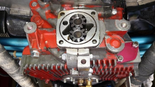

- Work included replacing the old oil pump (with hoses) with a new oil pump (without hoses).
New baffle material. I used the straight edge stuff this time.

New oil pump in place.
