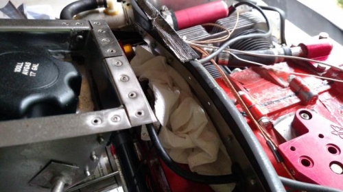

Brief Description:  Changing to Top Oil Cooler 2 of 3
- In photo 1 you can see I stuffed paper towels in the upper part of the engine mount, where the top magneto is. All of that area is open to the back of the engine and I didn't want ANY metal or shavings going down there!

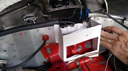

- Photo #2 shows the cuts at the rear baffle. I left a half inch or so of rubber baffles sticking out beyond the metal.
- Note that the #2 spark plug wire had passed through the rear baffle, but was not cut away with the center section. So the wire is laying loose in the photo. A new hole will need to be drilled to the right to install the rubber grommet and spark plug wire.
- In photo #3 I'm using a cardboard template to get the initial location and trimming done for the new baffle.
Paper towel to keep metal out of the back of the engine

Getting the shape right with a cardboard pattern.
