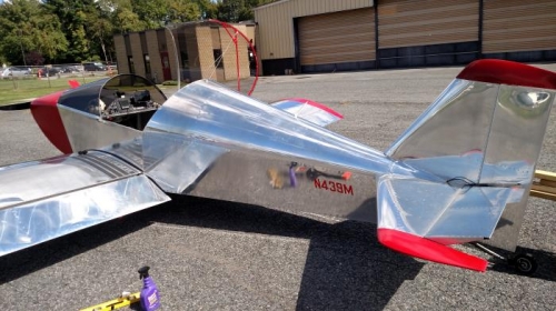

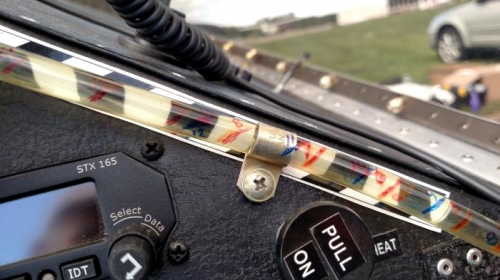

I decided to more accurately mark my clear fuel sight gauge. I started with a known 2 gallons in the tank. I had pre-marked my tank for 1, 2 and 3 gallons, with a Sharpie. I can easily see the marks and the fuel if I look under my instrument panel.
With the tail down in the "parked" position I put 1 gallon more in the tank, then marked the sight guage with a red Sharpie. That showed me 3 gallons on the tube.
Now I raised the tail to the level flight position. In that position the fuel is not visible in the sight tube.
With the tail down in the "parked" position I put 1 gallon more in the tank, then marked the sight guage with a red Sharpie. That showed me 4 gallons on the tube.
I raised the tail to the level flight position. In that position the fuel is still not visible in the sight tube.
With the tail down in the "parked" position I put 1 gallon more in the tank, then marked the sight guage with a red Sharpie. That showed me 5 gallons on the tube.
Now I raised the tail to the level flight position. In that position the fuel is finally visible in the tube so I marked it with a BLUE Sharpie (blue for "sky").
I continued this up to the 12 gallon mark. And finally I put in 5 more gallons to prove that the tank can hold 17 gallons in the parked position, and then I noted visually how far up the tank the fuel is when there is 17 gallons.
Level flight attitude. Mark sight with blue Sharpie.
Tail down, parked. Mark sight with red Sharpie.
Red and Blue Sharpie marks.
