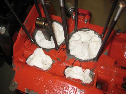

Paper towels so flying wrist pin clips won't get lost inside the engine!

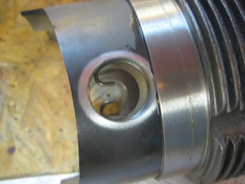

1st wrist pin clip is installed on the side of the piston closest to the flywheel.

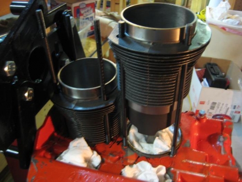

Permatex on the shim, then the cylinder slides into place.
