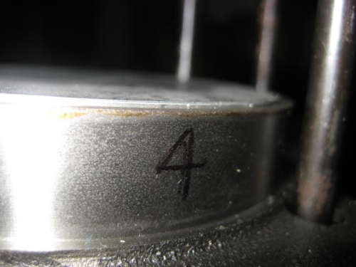

Measured all my deck heights and determined what shims I need on the cylinder bases to get my minimum 8.0 compression ratio. I used this web site to help with the calculations:

(This cylinder has a chamber volume and deck height much different than the others, so the shims need to be different to get a similar compression ratio)
Combustion chamber volume = 62.2 cc
Deck clearance = 1.19mm (** see below)
COMPRESSION RATIO = 8.1:1
** Deck clearance: without a barrel shim the deck height was -.71 mm. If I add a .045" (1.15mm) shim, and a .030" (.75mm) shim then => 1.9mm - 0.71mm = 1.19mm
