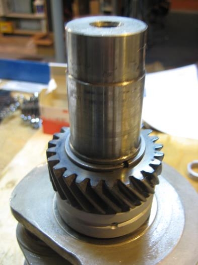

Date:  10-3-2015
Number of Hours:  0.00
Brief Description:  Timing gear installation
I had the crank in the freezer for the last 24 hours. Tonight I heated the timing gear to 500 deg. The #2 bearing went on first, and then the timing gear. I needed to tap it down with a block of wood and a hammer, but didn't need much force to do it. Got the snap ring on, then put the crank back in the freezer so I can do the prop hub tomorrow.
