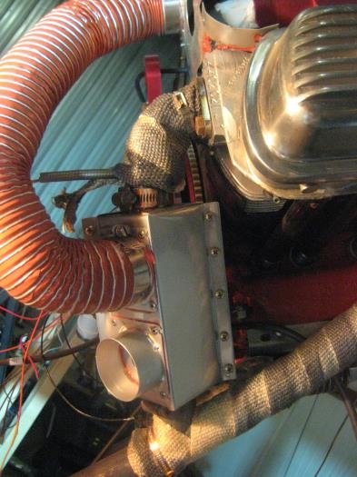

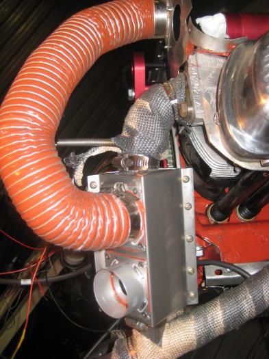

Brief Description:  New heat muff

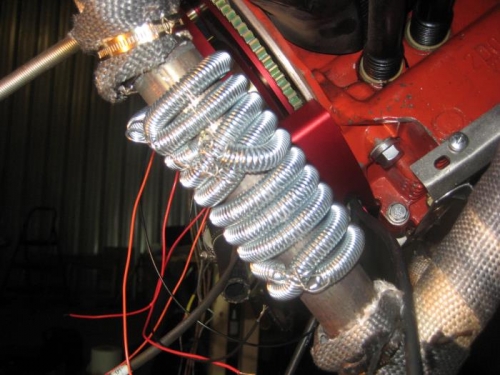

I made a new heat muff of stainless steel, with smaller openings to try to keep more heat inside the muff, before it goes to the cockpit. I also added more stainless steel springs to the exhaust (they gon on the inside of the muff) to try to get more surface area.
