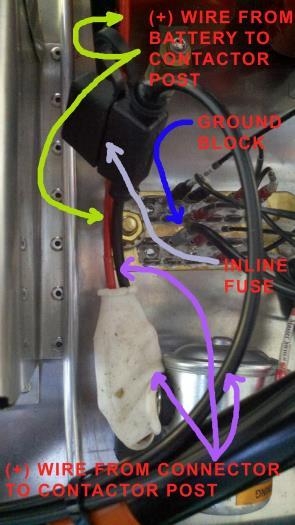

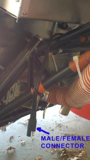

Brief Description:  Remote charging port (2 of 2)
The reason for using the contactor and the ground block was that I was out of room on the battery posts. There were already too many connectors on them. So I just attached my new wiring to the nearest connection points just slightly downstream from the battery. The connections are a foot or less away from the battery.
Male/female end connector, attached to contactor and ground block.

Other end of tha wire, attached to contactor post & ground block.
It works!
