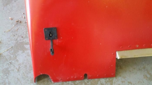

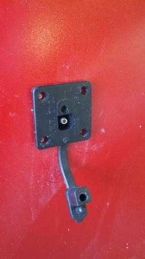

Charging port before screws installed.
Before screws...
Before screws...

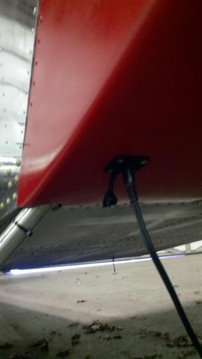

Battery charger plugged into port.
