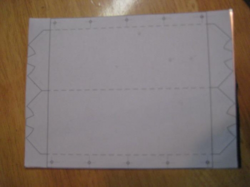

Pattern for 1/2 of heat muff

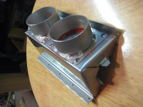

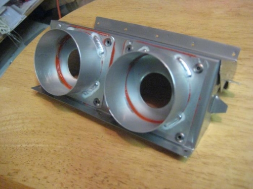

The other half made, with the in/out collars riveted in place.
In/out holes are much smaller than the first heater box.
