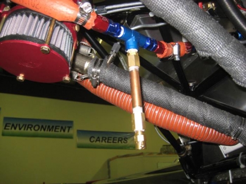

Drain extension
I added brass extensions to get the fuel drain to a location that will be below the cowl when it is on the plane.
Drain extension. It will go through a hole in the lower cowl.
