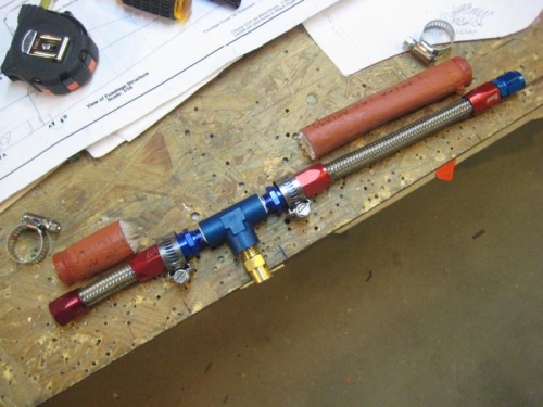

I needed to put a drain in the low point of the fuel line, just before the carburetor. I removed the original hose, cut in the new Tee fitting, and sealed the ends of the fire sleeve.
Working on a new fitting in the braided hose.
The completed assembly. The fire sleeve will go on later.

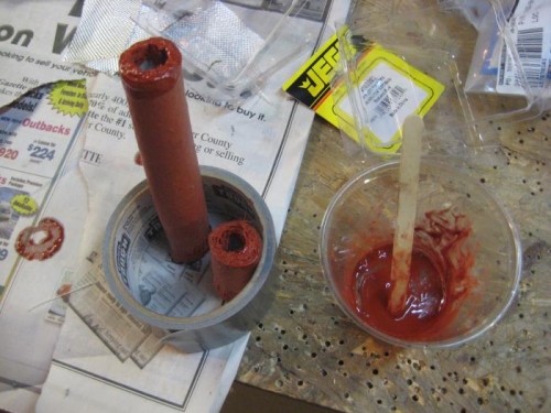

Red RTV in mineral spirits, to seal the exposed ends of the fire sleeve. Needs to dry overnight.
