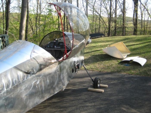

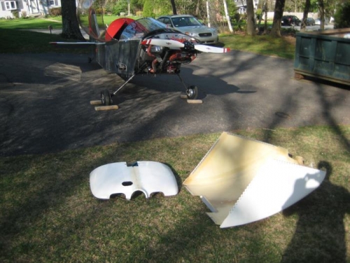

Today is Mother's Day, and I spent several hours on the airplane (pictures). Now THAT'S a wife! :-)
