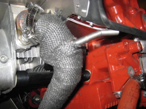

I received a new EGT probe from MGL today (for free!), as the previous one wasn't working. I tested this new one before installing and it worked (hooked it up to the RDAC, turned on the EFIS, and put a lighter under the probe).
Installed the probe in the exhaust. Again, the location would hit the cowl, so I bent over the probe with a vice and small sledge hammer.

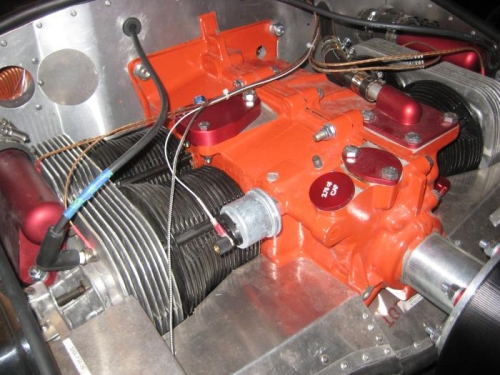

Routed the wire through the baffle, over the engine, and down to the RDAC. Barely enough wire to get there.

New probe in place
New probe in place
probe wire running over top of engine.

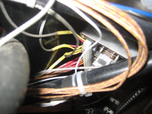

And connected to the RDAC box.
