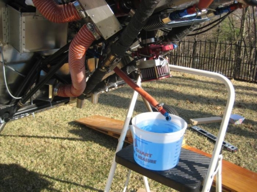

I did a first fuel flow test tonight. I disconnected the fuel hose from the carburetor and placed it in a bucket (photo 2). I had the bucket marked at 1 gallon. THIS test was done with 3 gallons in the tank, and so left it with 2 gallons. This is a good test of a high angle with low head pressure.

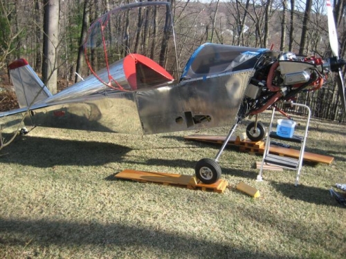

As I did on April 7, I did another fuel flow test, but this time at a climb angle. I had hoped to get to 25 degrees, but we were only able to get to 21 degrees (the angle of the hill + raising the front wheels).
I opened the fuel valve by pushing in the rod I have connected to the valve and timed how long it took to fill the bucket to 1 gallon.
It took 88 seconds (it was 82 seconds for the level test, so pretty close). If anyone wants to check my math:
- 1 gal came out in 88 seconds
- Flow(GPH) = 3600 X #Gallons/#Seconds
- 3600 x (1/88) = 40.9 gph

The hill is steeper than it looks. About 10 degrees.
By adding more material under the wheels/ramps, we got 21 degrees.
Fuel hose disconnected, and 1 gallon in the bucket.
