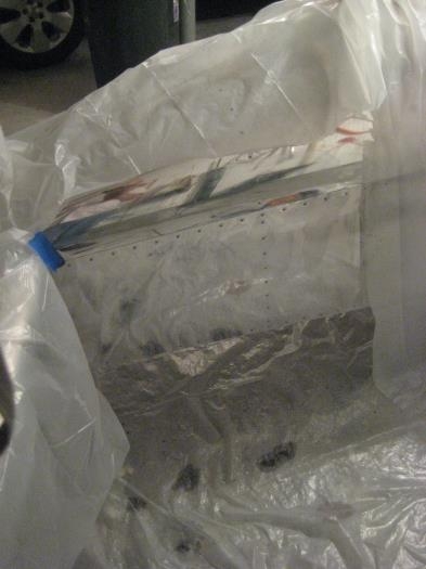

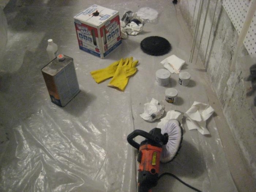

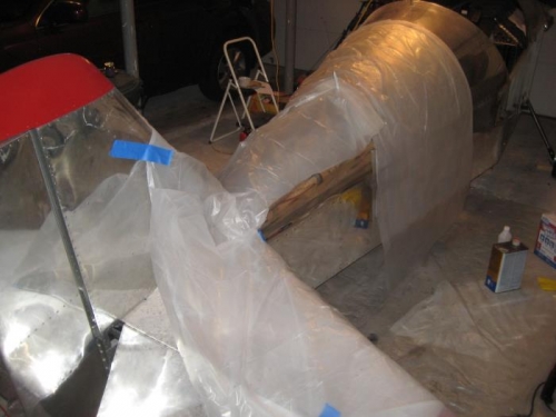

I want to put the registration numbers on the fuselage, so I am finish-polishing the areas to receive them, so I don't have to go over the numbers later with the polishing equipment. Did another F9 pass, then a C-grade pass. Got one side done tonight.
All the supplies are out again.
Plastic to keep the flung material off the rest of the plane.
Area exposed for polishing.
