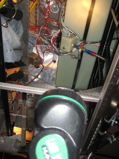

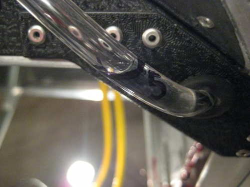

- Added fuel 1 gallon at a time. By shining a flashlight up at the underside of the fuel tank (photo 1) I could mark the tank at each increment (photo 2).
- At 5 gallons the bottom of the sight tube had visible fuel so I marked that on the tube (photo 3).
- I'll make cleaner lines with a straight edge later, and put numbers next to each.

Flashlight shining up to gas tank.
1 gallon increments marked on the tank
5 gallons is where it starts to show on the sight tube.
