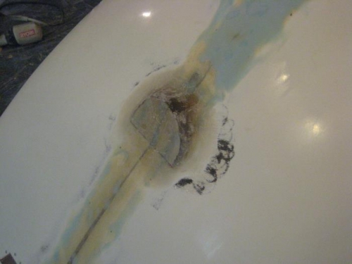

Air cleaner blister
I sanded out the blister and feathered the edges into the surrounding cowl. I wore through a high spot, so I added some glass to patch and smooth the area (that's the dark color in the middle of the photo).
A little more fiberglass work...
