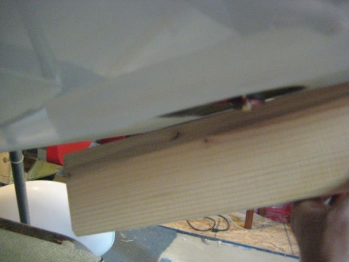

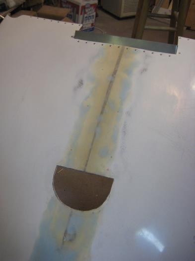

I cut out a section of the lower cowl to allow the air filter to fit. I put the lower cowl on, and it turns out the blister I made was way bigger than needed. In photo 2 you can see one corner, plus the bolts, protruding beyond the face of the cowl.

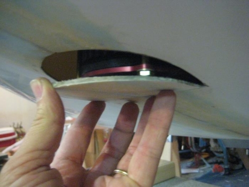

So I think what I will do is use the piece I cut out, angle it like photo 3, and glass that opening.

Cutout
Cutout
Blurry, but you an see the air filter partially beyond the cowl line.
I'll use the cutout piece and glass around it.
