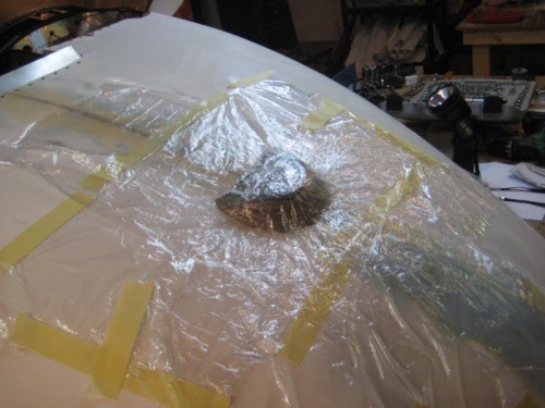

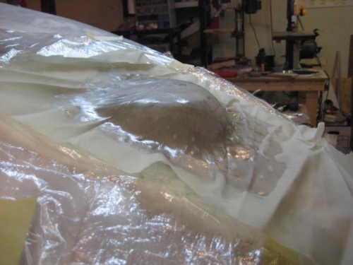

I used plastic cling wrap in several layers to cover the blister mold and the area around it. I then layed up 3 layers of fiberglass over the blister, and applied peel/ply.
Plastic cling wrap over the clay mold.
3 layers of fiberglass, with peel/ply over.
