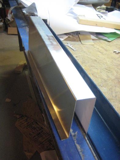

Spray-cemented the pattern for the pushrod tube cover, to some .025 aluminum. Cut out the basic shape, then bent it on the brake (photo 1).

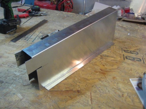

To make sure no small items can get past the pushrod cover I measured the existing structure behind the seat, and cut the cover to go around the structures (photos 2 and 3).

Bending the cover in the brake
Cutting notches to clear fuselage structures
Cover loosely fitted around structures
