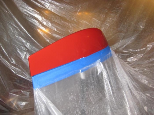

Brief Description:  Clear coat final tail tip
This is the last tail tip (vertical) that needs clear coating.
Unfortunately I got a serious run line on the left side. Reading online it looks like I need to wait several days for the paint to fully dry, then scrape the runs with the edge of a razor blade until level with the surrounding clear coat, wet-sand with 1500 grit paper, then buff out.
Vertical tail tip, clear coated.
