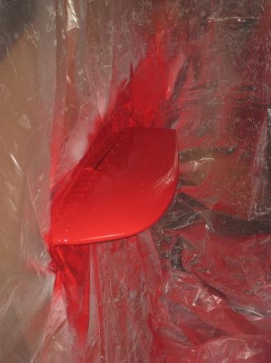

Brief Description:  Paint last tail tip
Added 4 color coats to the last, left, tail tip.
During a home emergency while I was away, the right horizontal tail paint job got dinged. So now I see how well I can make a paint repair. I sanded the edges of the ding to slope the perimeter. Then I filled the inside with paint from a paint brush, to build up some thickness. Next I'll have to mask the area and spray some coats.

Last horizontal tail tip painted.
