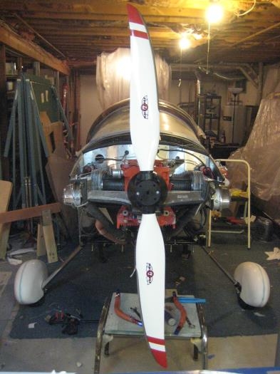

Brief Description:  Install prop

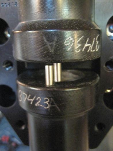

I got the new bolts from Sensenich, so I started reinstalling the prop. The instructions are lacking critical information about the orientation of the pins that create the prop pitch. Photo 2 has the pins on one side of each other, and photo 3 has them on the other side. Depending on which way they are installed has a HUGE effect on how the prop is adjusted.
Another user of the prop says A is right, with the engraved A's on the hubs facing one another. But when I adjust the blades it seems like they would actually be pushing the plane backward.
I've emailed Sensenich to get their input.
Prob blades in place
Option A
Option A
Option B
Option B
