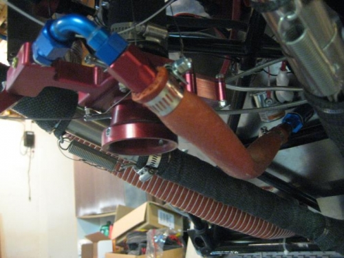

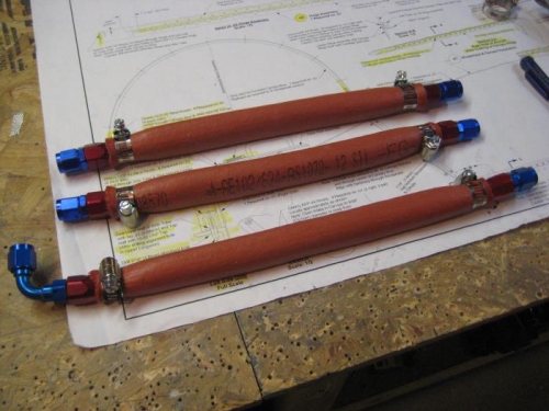

Slid the fire sleeve onto the fuel line and the 2 oil cooler lines, and secured them with clamps (photo 1).
Put teflon paste on the fuel threads and tightened down all the connections.
I'll need to do a fuel flow test soon, and check fuel flow and check for leaks.
Fire sleeve on fuel and oil cooler lines.

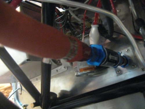

Fuel line connected to fuel strainer.
