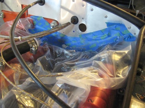

Driled a hole, with a step drill bit, in the rear baffle, to run the 1/2" oil breather through. I didn't want any metal shavings in the engine compartment so I taped plastic to catch all the shavings. On the other side of the baffle I taped up the openings around the flywheel so metal got in there, either.

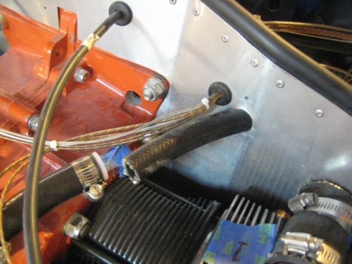

In photo 2 the breather tube is test fit through the hole.

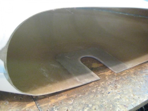

In photo 3, the end result of the glassed aluminum reinforcing in the wheel pants. Spent a little time trimming the fiberglass away from the edges, and sanding smooth.
Plastic to keep metal shavings out of engine compartment.
1/2
1/2" oil breather tubing test fit thru new hole in baffle.
Wheel pant aluminum reinforcing with fiberglass over the top.
