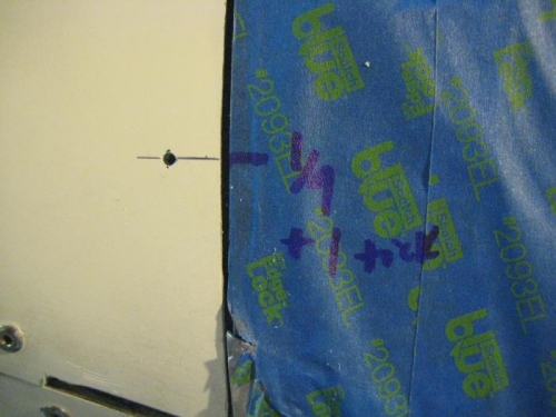

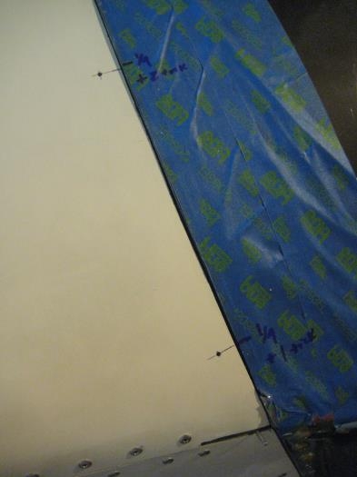

- Then I located and drilled the holes for the countersunk machine screws that will hold the upper cowling to the fuselage. The floating nut plates are already installed, to I needed to get the holes in the fiberglass cowl. With the cowl off I drew lines on the masking tape that is on the windscreen, aligned with the holes. Then I measured the distance from the windscreen edge to the centerine of each hole and marked the tape (photos 1 & 2) with the measurement.
- Now with the cowl on extended the centerlines, and measured to the center of the holes. I pilot drilled a very small hole and verified that it did not hit anything on the other side, indicating I got the pilot hole somewhere over the nut plate. Then I enlarged the holes to full size for the screws, and verified the alignment by inserting the screws. They worked!

Cowl at left; tape on windscreen at right. Tape marks made with cowl off.
Another view showing 2 hole locations.
