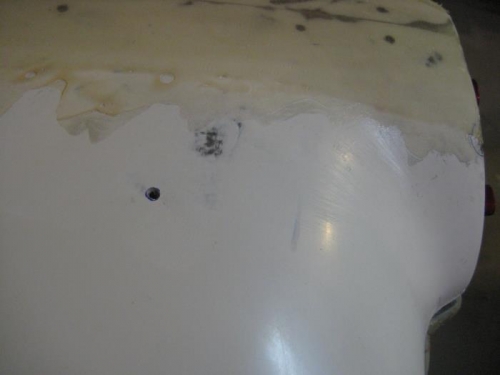

- By watching the shadow of my finger through the cowl (looking through the cooling inlet) I marked the location approximately over the oil filler.
- I drilled a pilot hole (photo 1) to verify that the filler was centered below.

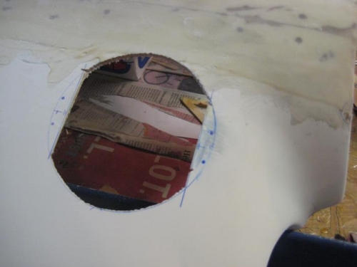

- Then I used the Dremel to cut out the flat-sided opening (photo 2).

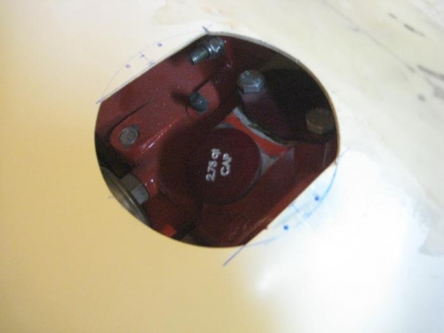

- After sanding all the edges I put it over the engine and it aligned perfectly.
Pilot hole to verity location of filler below.
Rough cutout, per plans.
Finished cutout, with cowl over engine.
