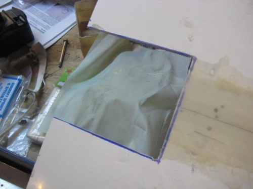

- I put the lower and upper cowls on the plane and marked for the fuel filler cutout.
- Cut out with the Dremel.

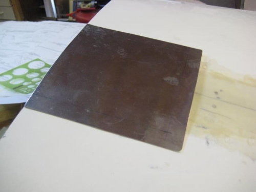

- Then used the cutout as the pattern for the fuel door. I made the door 5/8" wider than the cutout, on 3 sides.
Cut out.
Cut out.

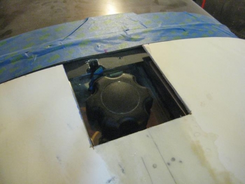

In place over the fuel filler.
0.025 aluminum fuel door, over the cutout.
