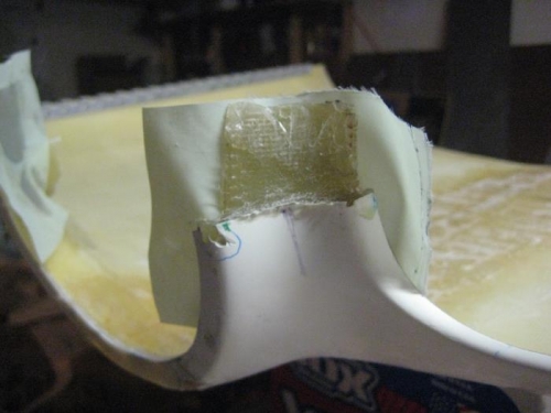

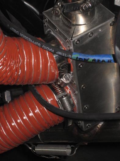

Cowl + heater SCAT
- Released the upper cowl (with the tabs) from the aluminized tape on the bottom cowl.
- Added 3 more layers of glass to the tabs to make them thicker.
- Found 2 stainless clamps and clamped the last two heater SCAT ducting. The heating system is now complete.
One of the new "tabs" (peel-ply in the background)
SCAT ducting on heat muff
