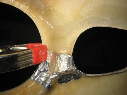

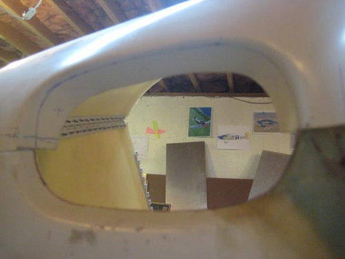

- Measured and drew lines for cutting the upper cowl intake openings (only the lower cowl has been done up to now).

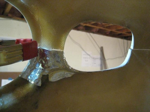

- Then put aluminum tape on the lower half of the cowl, and fiberglassed a "tab" that bonds with the upper cowl, but does not bond to the aluminum tape. 3 glass layers went on tonight (photo 3). At least 3 more will go on tomorrow.
- Then I can move to the other cowl intake and do the same.
- Eventually the tabs will have fasteners that go through the lowe cowl face and into the tabs, to hold the cowl together at those points.
Line for cutting the upper cowl.
Aluminum tape, to prepare for fiberglass tabs.
Though you might now see, there is a
Though you might now see, there is a "tab" spanning from the upper cowl, over the tape.
