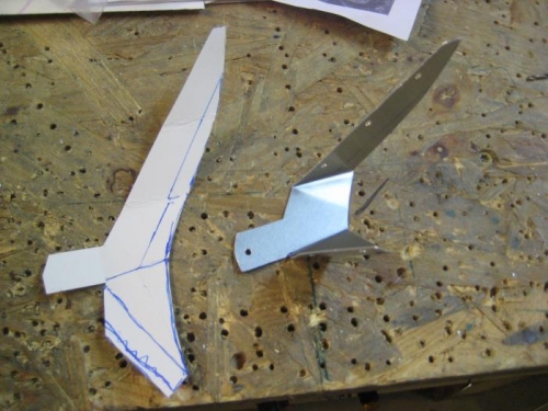

Oil Cooler Baffle
Took the 2 patterns off the oil cooler baffles, layed them out on .025 aluminum, and cut them out. Photo 1 shows one of the two patterns.
Finished the pieces' edges, bent them to shape, and added the pilot holes for joining to the existing baffles.
Set the new pieces in place and drilled the corresponding pilot holes in the existing baffles.
Pattern on left, cut and bent part on the right.
