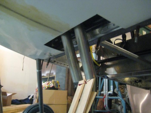

Put the exhaust pipes back on, then the cowl (photo 1). Now I can mark the ends of the pipes for cutting. Not much of the pipes need to be outside the cowl. Too much = more drag.
Photo 2 shows the result of the heavily modified cowl.

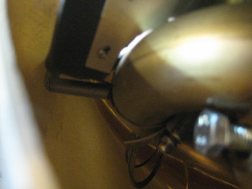

Photo 3 is a problem. When I test fit the cowl and the exhaust pipes, the CHT probes seemed to clear the cowl with little trouble. In photo 3 you can just see that the cowl is pressing heavily on the spring-end of the CHT probe on the pilot-side of the engine. Others had told me theirs cleared the cowl with no trouble. I wonder what's going on here and what I can do about it.
Now I can mark the exhausts for cutting. Very little needs be be outside the cowl.

Lower cowl with all modifications made. Primer and paint will show it to be smooth.

EGT probe pressed hard against the forward cowl.
