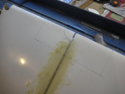

Worked on the cutout in the lower cowl for the exhaust pipes and the cooling air exit.
- First I put the cowl on and marked the edge where it met the forward fuselage. There was excess material so I needed to trim it back. Then took the cowl off again for the next step.

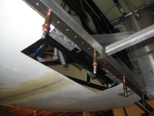

- Marked the 4"x12.5" cut (photo 1), and cut it out with a Dremel cutoff wheel (photo 2).

UPDATE October 2016:
- After flying for more than 2 years now, I have found the 4"x12.5" opening too SMALL to properly cool the engine.
- I opened my exit by around 20% and had much better results.
- I recommend you open your exit to at least 13.5"x4.5", or something like that.
- If you have a bottom mounted oil cooler I also recommend you make that opening smaller (see the updated post)
4"x12.5" cutout marked
Cut made with Dremel, then sanded smooth.
