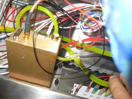

Transponder static connection
The static line needs to go to both the transponder and the EFIS, so I needed a Tee fitting. The static line to the transponder is narrower than the one to the EFIS, so I had to buy a tee fitting that had two 1/4" ends and a single 1/8" end.
Tee fitting to the left of the word "STATIC"
